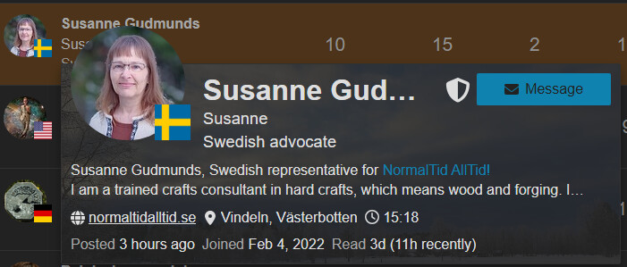

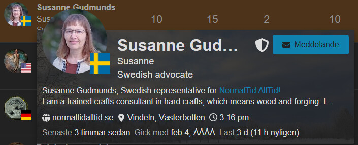

Hello,
Why are there different time systems depending on which interface I choose? In Sweden, we use the 24-hour system and not am/pm. Could it be an option, 12h/24h, when setting up the interface for one’s country?

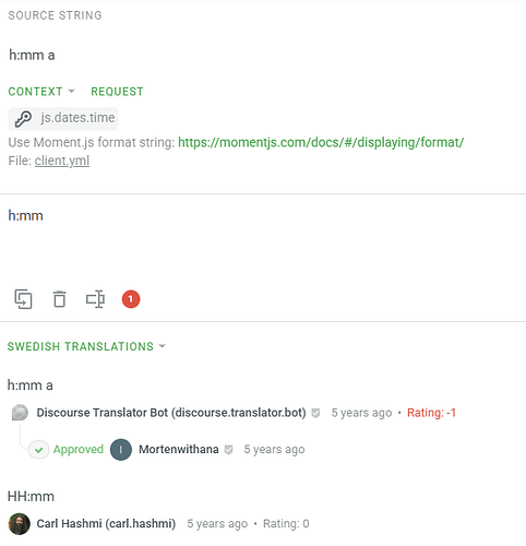

The time format depends on translations.
In this case, the key is js.dates.time.
You can adjust that on your forum by customizing the text. Then you don’t need to wait for an update to get this fixed. German for example uses HH:mm instead of h:mm a (You can learn about time formats here).
Of course in general it’s better when the Translation on Crowdin is updated, so the change applies to all forums.
Looks like someone already suggested something else 5 years ago. (Crowdin)
