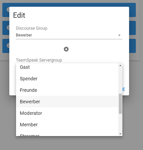

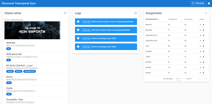

I’m currently working on a synchronization service between Discourse and TeamSpeak to sync user groups from Discourse to TeamSpeak 3.
This service is already working and I’m tweaking it at the moment. First-time preparation takes about 20 minutes for you.
Technically seen this is a Node.Js server using a server query library.

This Bridge Server syncs specified user groups from the Discourse Board to the TeamSpeak 3 Server. The server runs a cronjob every 5 minutes to sync both servers. This server is in early dev stage but it is fully working.
On server start the server will create a database file which has to be filled by you. It is a pivot table which contains the Group_ID of Discourse and TeamSpeak3.
