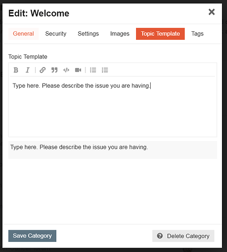

You can also set a Topic Template in each category
In the Edit Category dialog select Topic Templates. You can add a custom template for your category.
This works well BUT the user has to delete the template text before they can start typing their post.

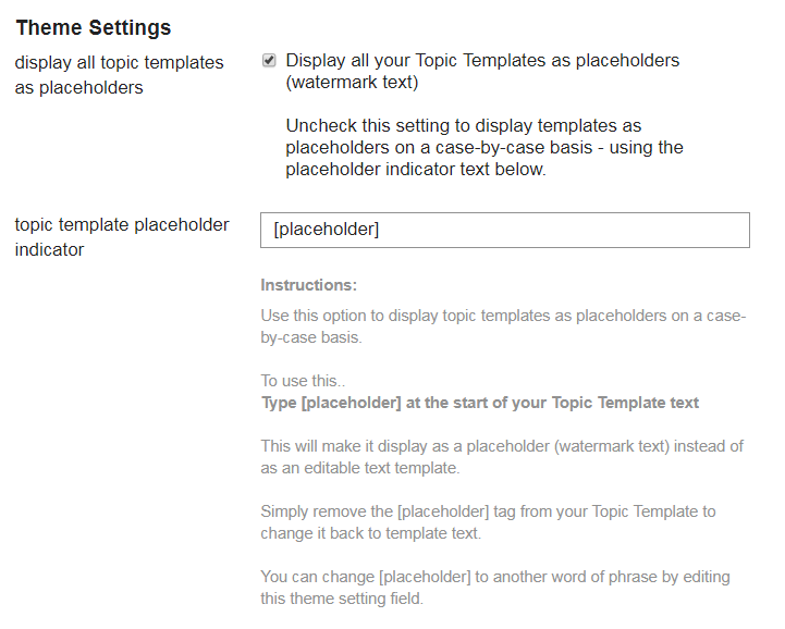

This theme component enables you to display the topic template text as a placeholder (watermark) text instead of the editable text. You simply click on the box and start typing.
It can be set to display all Topic Templates as placeholders, or you can do it on a case-by-case basis by adding a [placeholder] indicator to the Topic Template.
