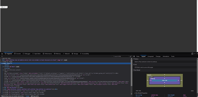

Ich habe gerade ein git pull ausgeführt und meine Discourse-Instanz neu aufgebaut. Der Webserver läuft, die Hintergrundprozesse werden geladen, aber es wird keine Benutzeroberfläche angezeigt. Im <body>-Tag wird praktisch nichts geladen. Ich habe versucht, die App neu zu bauen und den Server neu zu starten, doch das Problem besteht weiterhin.

Thanks. This is helping. I tried every combination of the three toggles on the safe mode page. The only combination where it still doesn’t load is when I disable my current theme but don’t disable unofficial plugins or all plugins. Does this mean it could be an issue between an official and unofficial plugin?
I haven't touched the plugins in a while. From my memory, I don't think I was running any unofficial plugins. This is wrong. I’m disabling one plugin at a time and rebuilding to see if I can isolate the issue.

Looks like I did have an old plugin screwing things up. Once I disabled it and rebuilt the app, the site works fine now. Having a minor issue with the color of the borders for the posts and topics list, but that is easily fixed with some css tweaks.
