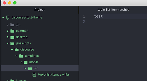

Nevertheless, I expect that adding a file like javascripts/discourse/templates/mobile/list/topic-list-item.raw.hbs in my theme will replace the mobile view but it doesn’t.
The method findRawTemplate still returning the default mobile template from discourse which contains:
Even by doing manual edition within my local Discourse project I am not able to get the mobile version to update with the changes.
Hopefully makes sense the explanation and someone has any knowledge about it, it looks really broken by now and maybe we want to fix it IF it is really broken (I can do so if I understand a bit more what’s going on)
Mean time I will continue looking for an answer myself and update any news. Below a small gif of what I have in my local.
http://g.recordit.co/AtOJlltJ8o
UPDATE: I have also update the raw to be .hbr as a recent commit changes the files but still not able to make it work.

Nevertheless, I have updated and the error remains when working with theme project structure (which probably is the most used for medium and large projects) I will drop this video here of me showing the error Loom | Free Screen & Video Recording Software
PD: I will leave the video for a while in case it is helpful for someone to understand the problem and reproduce it. I will need to delete the video after few weeks :grimacing:
NOTE: I also tried with renaming back to topic-list-item.raw.hbs instead topic-list-item.hbr and the issue is the same.
1 „Gefällt mir“
It’s working for me with the javascripts directory (with either the old or new extension).
One thing I did run into last night is that you may need to edit the file and save it, or remove the file and re-add it (the templates are compiled on save, so it’s possible you’re temporarily stuck in the buggy state.).
8 „Gefällt mir“
