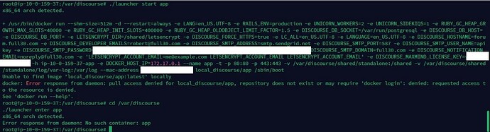

I’d like to @ somebody who can help

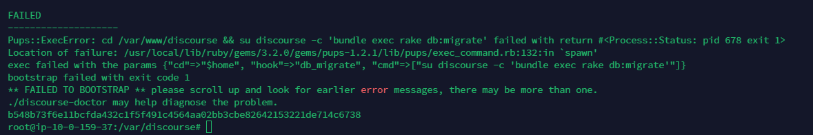

tried to build new, still no joy
log details

2023-11-15 20:25:43.361 UTC [716] discourse@discourse ERROR:  relation "summary_sections" already exists
2023-11-15 20:25:43.361 UTC [716] discourse@discourse STATEMENT:  CREATE TABLE "summary_sections" ("id" bigserial primary key, "target_id" integer NOT NULL, "target_type" character varying NOT NULL, "content_range" int4range, "summarized_text" character varying NOT NULL, "meta_section_id" integer, "original_content_sha" character varying NOT NULL, "algorithm" character varying NOT NULL, "created_at" timestamp(6) NOT NULL, "updated_at" timestamp(6) NOT NULL)
rake aborted!
StandardError: An error has occurred, this and all later migrations canceled: (StandardError)
PG::DuplicateTable: ERROR:  relation "summary_sections" already exists

/var/www/discourse/db/migrate/20230608163854_create_summary_sections_table.rb:5:in `change'

/var/www/discourse/vendor/bundle/ruby/3.2.0/gems/activerecord-7.0.7/lib/active_record/migration.rb:1092:in `migrate'
/var/www/discourse/vendor/bundle/ruby/3.2.0/gems/activerecord-7.0.7/lib/active_record/tasks/database_tasks.rb:262:in `migrate'
/var/www/discourse/lib/tasks/db.rake:255:in `block (2 levels) in <main>'
/var/www/discourse/lib/distributed_mutex.rb:53:in `block in synchronize'
/var/www/discourse/lib/distributed_mutex.rb:49:in `synchronize'
/var/www/discourse/lib/distributed_mutex.rb:34:in `synchronize'
/var/www/discourse/lib/tasks/db.rake:230:in `block in <main>'
/var/www/discourse/vendor/bundle/ruby/3.2.0/gems/rake-13.1.0/exe/rake:27:in `<top (required)>'
/usr/local/bin/bundle:25:in `load'
/usr/local/bin/bundle:25:in `<main>'
Caused by:
ActiveRecord::StatementInvalid: PG::DuplicateTable: ERROR:  relation "summary_sections" already exists (ActiveRecord::StatementInvalid)
/var/www/discourse/vendor/bundle/ruby/3.2.0/gems/rack-mini-profiler-3.1.1/lib/patches/db/pg.rb:110:in `exec'
/var/www/discourse/vendor/bundle/ruby/3.2.0/gems/rack-mini-profiler-3.1.1/lib/patches/db/pg.rb:110:in `async_exec'
/var/www/discourse/vendor/bundle/ruby/3.2.0/gems/activerecord-7.0.7/lib/active_record/connection_adapters/postgresql/database_statements.rb:48:in `block (2 levels) in execute'
/var/www/discourse/vendor/bundle/ruby/3.2.0/gems/activesupport-7.0.7/lib/active_support/concurrency/share_lock.rb:187:in `yield_shares'
/var/www/discourse/vendor/bundle/ruby/3.2.0/gems/activesupport-7.0.7/lib/active_support/dependencies/interlock.rb:41:in `permit_concurrent_loads'
/var/www/discourse/vendor/bundle/ruby/3.2.0/gems/activerecord-7.0.7/lib/active_record/connection_adapters/postgresql/database_statements.rb:47:in `block in execute'
/var/www/discourse/vendor/bundle/ruby/3.2.0/gems/activesupport-7.0.7/lib/active_support/concurrency/load_interlock_aware_monitor.rb:25:in `handle_interrupt'
/var/www/discourse/vendor/bundle/ruby/3.2.0/gems/activesupport-7.0.7/lib/active_support/concurrency/load_interlock_aware_monitor.rb:25:in `block in synchronize'
/var/www/discourse/vendor/bundle/ruby/3.2.0/gems/activesupport-7.0.7/lib/active_support/concurrency/load_interlock_aware_monitor.rb:21:in `handle_interrupt'
/var/www/discourse/vendor/bundle/ruby/3.2.0/gems/activesupport-7.0.7/lib/active_support/concurrency/load_interlock_aware_monitor.rb:21:in `synchronize'
/var/www/discourse/vendor/bundle/ruby/3.2.0/gems/activerecord-7.0.7/lib/active_record/connection_adapters/abstract_adapter.rb:752:in `block in log'
/var/www/discourse/vendor/bundle/ruby/3.2.0/gems/activesupport-7.0.7/lib/active_support/notifications/instrumenter.rb:24:in `instrument'
/var/www/discourse/vendor/bundle/ruby/3.2.0/gems/activerecord-7.0.7/lib/active_record/connection_adapters/abstract_adapter.rb:743:in `log'
/var/www/discourse/vendor/bundle/ruby/3.2.0/gems/activerecord-7.0.7/lib/active_record/connection_adapters/postgresql/database_statements.rb:46:in `execute'
/var/www/discourse/vendor/bundle/ruby/3.2.0/gems/activerecord-7.0.7/lib/active_record/connection_adapters/abstract/schema_statements.rb:326:in `create_table'
/var/www/discourse/vendor/bundle/ruby/3.2.0/gems/activerecord-7.0.7/lib/active_record/migration.rb:932:in `block in method_missing'
/var/www/discourse/vendor/bundle/ruby/3.2.0/gems/activerecord-7.0.7/lib/active_record/migration.rb:900:in `block in say_with_time'
/var/www/discourse/vendor/bundle/ruby/3.2.0/gems/activerecord-7.0.7/lib/active_record/migration.rb:900:in `say_with_time'
/var/www/discourse/vendor/bundle/ruby/3.2.0/gems/activerecord-7.0.7/lib/active_record/migration.rb:921:in `method_missing'
/var/www/discourse/vendor/bundle/ruby/3.2.0/gems/activerecord-7.0.7/lib/active_record/migration.rb:870:in `exec_migration'
/var/www/discourse/lib/freedom_patches/schema_migration_details.rb:8:in `block in exec_migration'
/var/www/discourse/lib/freedom_patches/schema_migration_details.rb:8:in `exec_migration'
/var/www/discourse/vendor/bundle/ruby/3.2.0/gems/activerecord-7.0.7/lib/active_record/migration.rb:854:in `block (2 levels) in migrate'
/var/www/discourse/vendor/bundle/ruby/3.2.0/gems/activerecord-7.0.7/lib/active_record/migration.rb:853:in `block in migrate'
/var/www/discourse/vendor/bundle/ruby/3.2.0/gems/activerecord-7.0.7/lib/active_record/connection_adapters/abstract/connection_pool.rb:215:in `with_connection'
/var/www/discourse/vendor/bundle/ruby/3.2.0/gems/activerecord-7.0.7/lib/active_record/migration.rb:852:in `migrate'
/var/www/discourse/vendor/bundle/ruby/3.2.0/gems/activerecord-7.0.7/lib/active_record/migration.rb:1046:in `migrate'
/var/www/discourse/vendor/bundle/ruby/3.2.0/gems/activerecord-7.0.7/lib/active_record/migration.rb:1360:in `block in execute_migration_in_transaction'
/var/www/discourse/vendor/bundle/ruby/3.2.0/gems/activerecord-7.0.7/lib/active_record/connection_adapters/abstract/transaction.rb:319:in `block in within_new_transaction'
/var/www/discourse/vendor/bundle/ruby/3.2.0/gems/activerecord-7.0.7/lib/active_record/connection_adapters/abstract/transaction.rb:317:in `within_new_transaction'
/var/www/discourse/vendor/bundle/ruby/3.2.0/gems/activerecord-7.0.7/lib/active_record/connection_adapters/abstract/database_statements.rb:316:in `transaction'
/var/www/discourse/vendor/bundle/ruby/3.2.0/gems/activerecord-7.0.7/lib/active_record/transactions.rb:209:in `transaction'
/var/www/discourse/vendor/bundle/ruby/3.2.0/gems/activerecord-7.0.7/lib/active_record/migration.rb:1411:in `ddl_transaction'
/var/www/discourse/vendor/bundle/ruby/3.2.0/gems/activerecord-7.0.7/lib/active_record/migration.rb:1359:in `execute_migration_in_transaction'
/var/www/discourse/vendor/bundle/ruby/3.2.0/gems/activerecord-7.0.7/lib/active_record/migration.rb:1333:in `each'
/var/www/discourse/vendor/bundle/ruby/3.2.0/gems/activerecord-7.0.7/lib/active_record/migration.rb:1333:in `migrate_without_lock'
/var/www/discourse/vendor/bundle/ruby/3.2.0/gems/activerecord-7.0.7/lib/active_record/migration.rb:1282:in `block in migrate'
/var/www/discourse/vendor/bundle/ruby/3.2.0/gems/activerecord-7.0.7/lib/active_record/migration.rb:1432:in `block in with_advisory_lock'
/var/www/discourse/vendor/bundle/ruby/3.2.0/gems/activerecord-7.0.7/lib/active_record/migration.rb:1447:in `with_advisory_lock_connection'
/var/www/discourse/vendor/bundle/ruby/3.2.0/gems/activerecord-7.0.7/lib/active_record/migration.rb:1428:in `with_advisory_lock'
/var/www/discourse/vendor/bundle/ruby/3.2.0/gems/activerecord-7.0.7/lib/active_record/migration.rb:1282:in `migrate'
/var/www/discourse/vendor/bundle/ruby/3.2.0/gems/activerecord-7.0.7/lib/active_record/migration.rb:1117:in `up'
Caused by:
PG::DuplicateTable: ERROR:  relation "summary_sections" already exists (PG::DuplicateTable)
Tasks: TOP => db:migrate
(See full trace by running task with --trace)
I, [2023-11-15T20:25:43.395548 #1]  INFO -- : == 20230608163854 CreateSummarySectionsTable: migrating =======================
-- create_table(:summary_sections)
I, [2023-11-15T20:25:43.396019 #1]  INFO -- : Terminating async processes
I, [2023-11-15T20:25:43.396100 #1]  INFO -- : Sending INT to HOME=/var/lib/postgresql USER=postgres exec chpst -u postgres:postgres:ssl-cert -U postgres:postgres:ssl-cert /usr/lib/postgresql/13/bin/postmaster -D /etc/postgresql/13/main pid: 42
I, [2023-11-15T20:25:43.396499 #1]  INFO -- : Sending TERM to exec chpst -u redis -U redis /usr/bin/redis-server /etc/redis/redis.conf pid: 111
2023-11-15 20:25:43.396 UTC [42] LOG:  received fast shutdown request
111:signal-handler (1700079943) Received SIGTERM scheduling shutdown...
2023-11-15 20:25:43.407 UTC [42] LOG:  aborting any active transactions
111:M 15 Nov 2023 20:25:43.411 # User requested shutdown...
111:M 15 Nov 2023 20:25:43.412 * Saving the final RDB snapshot before exiting.
2023-11-15 20:25:43.412 UTC [42] LOG:  background worker "logical replication launcher" (PID 51) exited with exit code 1
2023-11-15 20:25:43.413 UTC [46] LOG:  shutting down
2023-11-15 20:25:43.492 UTC [42] LOG:  database system is shut down
111:M 15 Nov 2023 20:25:43.506 * DB saved on disk
111:M 15 Nov 2023 20:25:43.506 # Redis is now ready to exit, bye bye...
FAILED
Pups::ExecError: cd /var/www/discourse && su discourse -c 'bundle exec rake db:migrate' failed with return #<Process::Status: pid 678 exit 1>
Location of failure: /usr/local/lib/ruby/gems/3.2.0/gems/pups-1.2.1/lib/pups/exec_command.rb:132:in `spawn'
exec failed with the params {"cd"=>"$home", "hook"=>"db_migrate", "cmd"=>["su discourse -c 'bundle exec rake db:migrate'"]}
bootstrap failed with exit code 1
be80b7f3900027b447bca8c30b16d539bf137dc6ffd54e8876a9758ffcf72eb4
root@ip-10-0-159-37:/var/discourse#

2023-11-15 20:32:18.854 UTC [714] discourse@discourse ERROR:  relation "summary_sections" already exists
2023-11-15 20:32:18.854 UTC [714] discourse@discourse STATEMENT:  CREATE TABLE "summary_sections" ("id" bigserial primary key, "target_id" integer NOT NULL, "target_type" character varying NOT NULL, "content_range" int4range, "summarized_text" character varying NOT NULL, "meta_section_id" integer, "original_content_sha" character varying NOT NULL, "algorithm" character varying NOT NULL, "created_at" timestamp(6) NOT NULL, "updated_at" timestamp(6) NOT NULL)
rake aborted!

FAILED
Pups::ExecError: cd /var/www/discourse && su discourse -c 'bundle exec rake db:migrate' failed with return #<Process::Status: pid 677 exit 1>
0c9d252453bcca940ed7bb547990964e60fa5b97af0fd0313ca5fb537fe8af21
==================== END REBUILD LOG ====================
Failed to rebuild app.
Checking your domain name . . .
Connection to forum.full30.com succeeded.
You should probably remove any non-standard plugins and rebuild.
Attempting to restart existing container. . .
x86_64 arch detected.
+ /usr/bin/docker run --shm-size=512m -d --restart=always -e LANG=en_US.UTF-8 -e RAILS_ENV=production -e UNICORN_WORKERS=2 -e UNICORN_SIDEKIQS=1 -e RUBY_GC_HEAP_GROWTH_MAX_SLOTS=40000 -e RUBY_GC_HEAP_INIT_SLOTS=400000 -e RUBY_GC_HEAP_OLDOBJECT_LIMIT_FACTOR=1.5 -e DISCOURSE_DB_SOCKET=/var/run/postgresql -e DISCOURSE_DB_HOST= -e DISCOURSE_DB_PORT= -e LETSENCRYPT_DIR=/shared/letsencrypt -e DISCOURSE_FORCE_HTTPS=true -e LC_ALL=en_US.UTF-8 -e LANGUAGE=en_US.UTF-8 -e DISCOURSE_HOSTNAME=forum.full30.com -e DISCOURSE_DEVELOPER_EMAILS=robert@full30.com -e DISCOURSE_SMTP_ADDRESS=smtp.sendgrid.net -e DISCOURSE_SMTP_PORT=587 -e DISCOURSE_SMTP_USER_NAME=apikey -e DISCOURSE_SMTP_PASSWORD=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 -e DISCOURSE_SMTP_DOMAIN=full30.com -e DISCOURSE_NOTIFICATION_EMAIL=noreply@full30.com -e 'LETSENCRYPT_ACCOUNT_EMAIL=me@example.com LETSENCRYPT_ACCOUNT_EMAIL LETSENCRYPT_ACCOUNT_EMAIL' -e DISCOURSE_MAXMIND_LICENSE_KEY=yLFCaSpeHmWVD2Y7 -h ip-10-0-159-37-app -e DOCKER_HOST_IP=172.17.0.1 --name app -t -p 80:80 -p 443:443 -v /var/discourse/shared/standalone:/shared -v /var/discourse/shared/standalone/log/var-log:/var/log --mac-address 02:a7:94:ef:88:8b local_discourse/app /sbin/boot
Unable to find image 'local_discourse/app:latest' locally
docker: Error response from daemon: pull access denied for local_discourse/app, repository does not exist or may require 'docker login': denied: requested access to the resource is denied.
See 'docker run --help'.
Failed to restart the container.
==================== PLUGINS ====================
No non-official plugins detected.
See https://github.com/discourse/discourse/blob/main/lib/plugin/metadata.rb for the official list.
Discourse version at forum.full30.com: NOT FOUND
Discourse version at localhost: NOT FOUND

Cela ressemble à l’erreur fatale, qui a exécuté cette commande ?
Quelque chose ne va pas avec votre base de données. le script de lancement exécute rake db:migrate pour appliquer toutes les nouvelles migrations qui ont été ajoutées depuis la dernière fois que votre instance Discourse a été mise à jour. Pour une raison quelconque, il tente d’exécuter des migrations qui ont déjà été appliquées.
Je crains de ne pas être un expert, mais d’après des problèmes similaires précédents, je pense qu’il a été conseillé de supprimer la table. Par exemple, celle-ci :
Avez-vous des idées sur la façon de corriger ?

ubuntu@ip-10-0-159-37:~$ sudo -s
root@ip-10-0-159-37:/home/ubuntu# su - postgres
psql discourse
su: user postgres does not exist or the user entry does not contain all the required fields
Command 'psql' not found, but can be installed with:
apt install postgresql-client-common
n’y était pas et a proposé de le mettre là, alors je l’ai fait

Et ensuite, je peux exécuter
cd /var/discourse
./launcher rebuild app
ce qui se termine par un échec.
Essayez de
./launcher start app
Avant d’essayer d’entrer dans le conteneur. L’ancien conteneur devrait toujours être disponible et pouvoir démarrer. Ensuite, vous pourrez essayer de réparer votre base de données.
Quelques points si quelqu’un d’autre se retrouve bloqué de cette façon.
D’abord, n’exécutez pas ./launcher cleanup, mais plutôt ./launcher start app pour redémarrer votre conteneur existant. Vous pourrez alors faire quelque chose comme :
./launcher enter app
su - postgres
psql discourse
drop table ...
Sans le conteneur dans lequel entrer et parler directement à postgres, vous devez le faire pendant la construction du conteneur en ajoutant quelque chose comme ceci à votre app.yml :
hooks:
  after_postgres:
      - exec: /bin/bash -c 'sudo -u postgres psql discourse <<EOF "drop table summary_sections;"'
      - exec: /bin/bash -c 'sudo -u postgres psql discourse <<EOF "drop table theme_settings_migrations;"'
Je ne sais pas comment ces deux tables ont été créées de telle sorte que les migrations étaient désynchronisées, mais c’était une solution. Et c’était encore plus étrange, car la base de données avait été effacée d’une manière ou d’une autre et une fois que j’ai corrigé cela, c’était une toute nouvelle base de données, donc elle a dû être arrêtée quelque part au milieu d’une migration à un moment donné.
