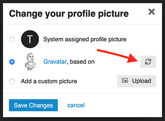

Did you try hitting this button?
mcwumbly
(Dave McClure)
2016 年 12 月 16 日午後 3:24
3
Yeah, I tried that. The image in that dialog did not change. I just tried clicking “Save Changes” anyway… haven’t seen it update yet.
