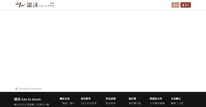

After upgrading from Discourse 3.3.0 to 3.4.0, new users are seeing a blank page (header and footer only) when clicking the email verification link to reach the “activate-account” page.

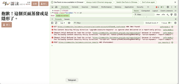

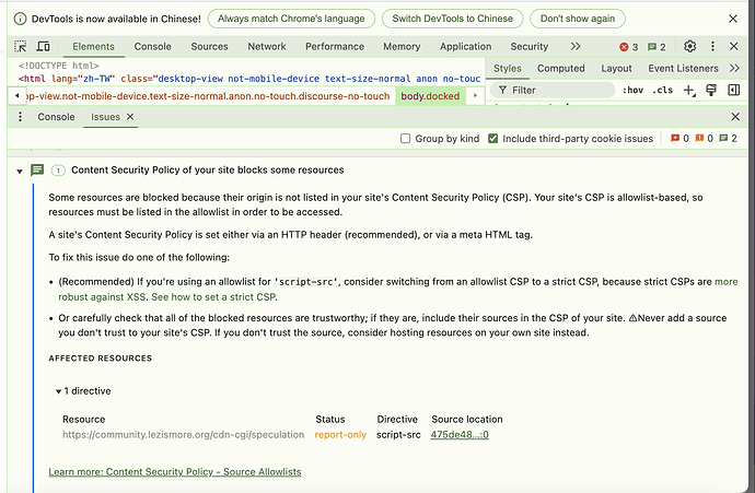

Checked Developer Console : Error indicates CSP blocking external scripts.

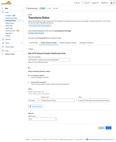

Tried Modifying CSP through Cloudflare :
Adjusted the policy and cleared the cache, but it didn’t resolve the issue.

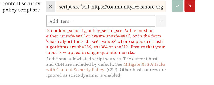

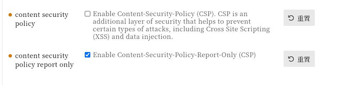

Tried Modifying CSP through Discourse Admin Panel : Added ‘self’, ‘unsafe-eval’, and attempted SHA256 hashing. We also referenced this article but saw no change.
error message:
Tried various inputs (e.g., ‘self’, ‘unsafe-eval’) and even set the policy to “report only” mode. Still, no effect.

There is another site reporting CSP errors related to the /cdn-cgi/speculation
endpoint: Refused to load the script 'xxxx.com/cdn-cgi/speculation' because it violates the following Content Security Policy directive - #2 by simon . I am not aware of similar issues that have been reported in the past. Maybe something has changed either on Cloudflare or in Discourse 3.4.0.
The /cdn-cgi/speculation
endpoint is added to domains registered on Cloudflare when the “Speed Brain” feature is enabled. Speed Brain is intended to speed up a website’s performance by allowing Cloudflare to prefetch content when a user hovers over a link. I’m not sure this is compatible with Discourse.
I see the Speculation-Rules
header is being returned with the response when I visit https://community.lezismore.org/login

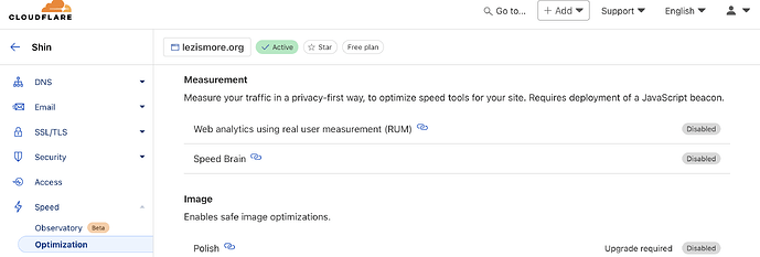

. That indicates that the Speed Brain feature is enabled. From the Cloudflare docs, it seems that it is enabled by default.
Can you try disabling Speed Brain from the Speed tab of your Cloudflare dashboard? Instructions for how to do that are here: Speed Brain | Cloudflare Speed docs .
The “Caveats” section of the docs I linked to says:
Speed Brain will not work with restrictive Content Security Policy configurations using strict-dynamic
or nonce-{hash}
attributes.
If Speed Brain is compatible with Discourse, we’ll have to figure out how to add it to the Content Security rules.

I have already disabled the Speed Brain setting in Cloudflare and cleared the cache as suggested, but unfortunately, the issue persists.
Here’s the link to today’s new testing active account page, for anyone who’s interested: https://community.lezismore.org/users/activate-account/34180b9eed9e1a1a1dbcca7eab66fb43

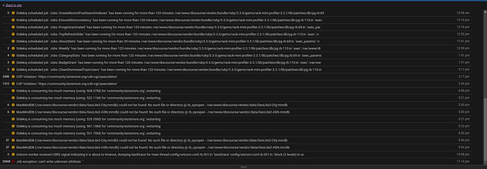

Are you able to login to the site? If so, do you see any error messages on its error logs page (https://community.lezismore.org/logs )?

Yes I can login in the website.
Here is the log page:
Job exception: can't write unknown attribute
and the details are following:

There are some other errors that I’m not sure are relevant, but I’m providing them anyway for reference, just in case.
Message
Job exception: PG::SyntaxError: ERROR: zero-length delimited identifier at or near """"
