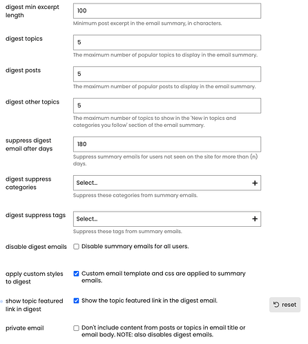

Hi, digest emails haven’t been sent from my forum and I’m not too sure why.
Here are my digest email settings:

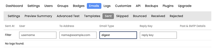

And when searching “digest” in email logs nothing shows up.

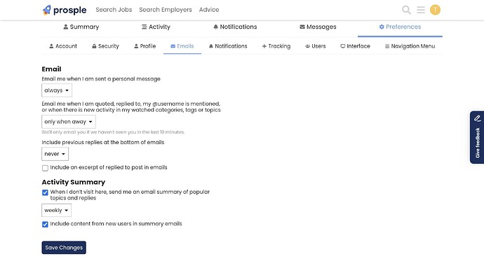

The setting is ‘default email digest frequency’. The configuration options are also explained in the Admin guide to Activity Summary emails.
Hmnm but mine is already set to “weekly” as seen in the screenshot attached.
Could there be any other factors affecting this?
Is your forum https://forum.prosple.com?
I just created an account there and the digest frequency is weekly by default.

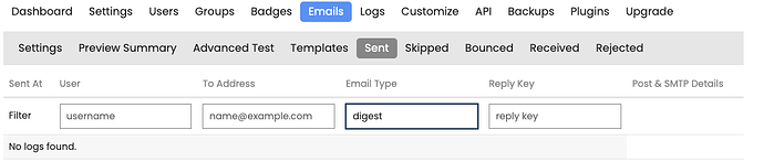

Nothing shows up in the logs either
Are you sure Admin - Settings - Email - disable digest emails is not checked?
Is digest suppress categories empty?
Hi Richard!
Yep, have made sure those settings are correct.
The settings are the same as the screenshot I uploaded at the start of this thread.
