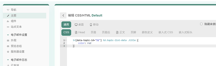

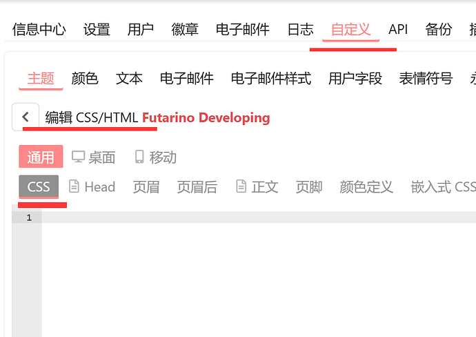

Thank you for your response. I wonder, where should this code be added or configured?
tr[data-topic-id="314580"] td.topic-list-data .title {
        color: red

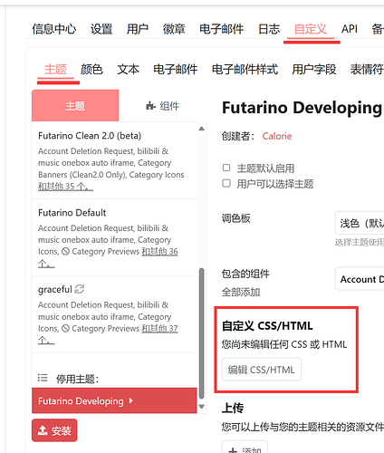

Here:

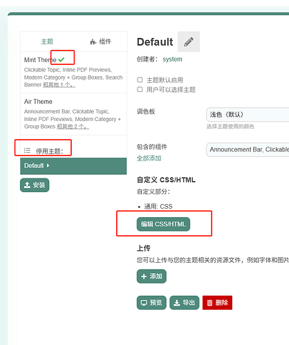

I took a look, and the only theme with the custom CSS/HTML option deactivated is mine. Is this where I can set it up?

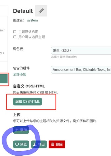

Does it work when you use the preview button?
Hello, I tested the preview and the pop-up page still didn’t see the specified ID’s theme color change.

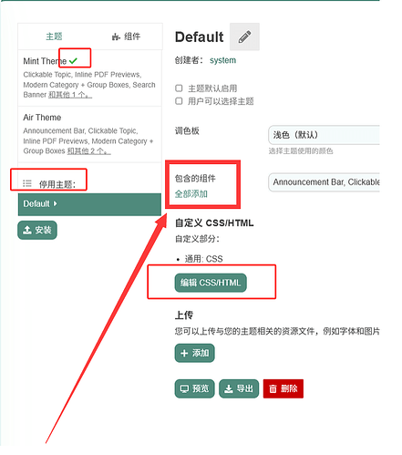

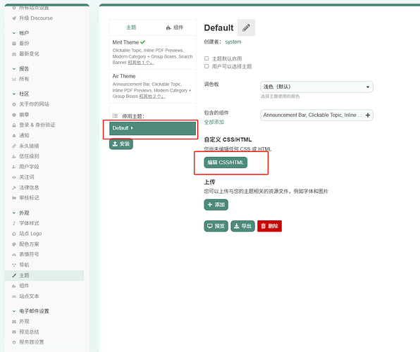

I found that only the default theme has the “Edit CSS/HTML” option, other added themes do not have this option. However, even if I enable the default theme, the color of the title I modified still does not change. I’m not sure where I went wrong in the process.
This is quite handy as you could color title via cat/sub or tag.
Because those themes you installed were pre-written by others and cannot be modified
The solution is to try to create a theme component and then include it in your enabled theme
Create a theme component and add it using this:

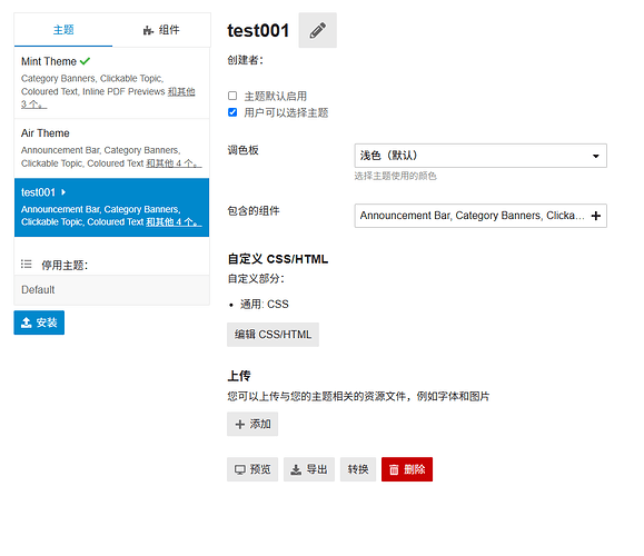

Hello, I tried creating a new theme test. However, whether it is previewing the theme or switching to this theme, the title color of the corresponding ID still has not changed at all. I don’t know where else I need to make adjustments.
Then try adding the !important flag
tr[data-topic-id="51"] td.topic-list-data .title {
    color: red !important;
Wow! Instantly effective, you’re amazing!
Wow! It works instantly, you’re amazing!
Is it because the priority is not enough?
Yes, I’m too lazy to see where the CSS has taken effect.
