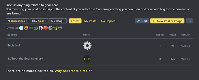

I am trying to remove some categories in favor of using tags, but I end up with one system created topic that I cannot delete (it is Technical in the screenshot, notice the -1 replies). If I try to visit this topic the page freezes and I have to close the tab and start over. Any idea how to delete this, possibly in rails?

Thanks Daniela, that worked to delete the topic, but now when I try to delete the category it still thinks there is one topic and won’t allow me to delete the category. Similar function to delete the category?

There are 0 topics to delete in discussions/gear category yet I still can’t delete the category Can't delete this category because topic count is 1.

I was able to reset the topic count using
Category.find_by(name: 'Gear').update(topic_count: 0)
And then was able to delete the category, thanks David!
