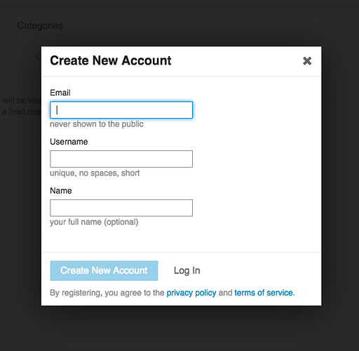

I did all the steps but I having two kind of problems:
  1. I can do the Auth0 authentication but it’s not copying user information to Discourse Dialog Window to create a new user. I have to write all the information on user creation.
  2. If I create a new user as I told in step 1, it’s receiving the email and user of the last user that was created. It’s sounds very weird.
If you have a tip to fix it or if I am doing something wrong, please let me know.
Thanks, Sergio

I looked now and “OIDC Conformant” is turned off.
My configuration:
All the new users are authenticated in Auth0 and at Auth0’s log everything is fine. But the information is not copied to create a new user in Discourse.
On the Discourse side can you remove “oauth2 json username path” , “oauth2 json name path”, and “oauth2 json avatar path” for now. Then can you update “oauth2 json email path” to “email”. Let’s see if we can just get that working, then we can work on the other fields.
