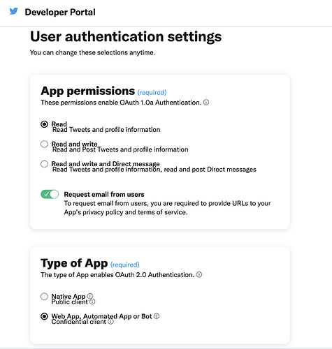

It seems that when we register as a developer account and we want to create an app, it forces us to apply for elevated access for a “project app”, which we don’t need. We just need a “standalone app” to be able to create a Twitter login for Discourse. Elevated access will make the login feature half-broken for some reason.
They might change the process and/or the interface in the short future, so I prefer to wait before working again on it.

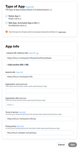

Also, whatever app you create (project or standalone), rich embeds won’t work currently. It will only work for existing apps with no “type of app” selected (the input choice is not required, but it wasn’t before).

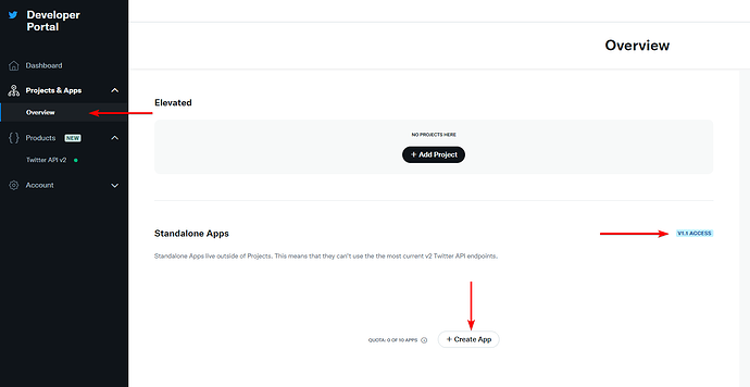

When they have approved your app (or if you already have an approved developer account and are able to create apps), then you need to go to your dashboard and create a standalone app:
Then follow the steps, it’s straightforward.

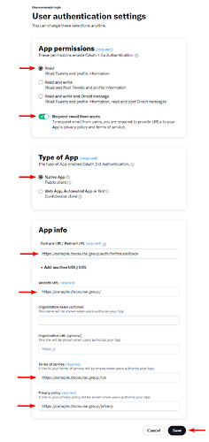

In your app in the Twitter Dashboard, go to the app settings and configure it like this:
You should be able to properly log-in with Twitter, but Rich Embeds won’t work.

It’s because of the “type of app” required setting. Whatever option you choose, Rich Embeds won’t work.
If your app was created at a time when this setting didn’t exist/wasn’t required, then Rich Embeds work.
