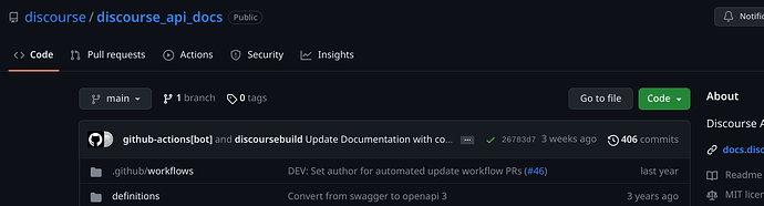

  1. From your home directory, clone the repository at https://github.com/discourse/discourse_api_docs:
    git clone https://github.com/discourse/discourse_api_docs
  2. You should now have the discourse and discourse_api_docs folders side by side:
    ~/discourse/
    ~/discourse_api_docs/

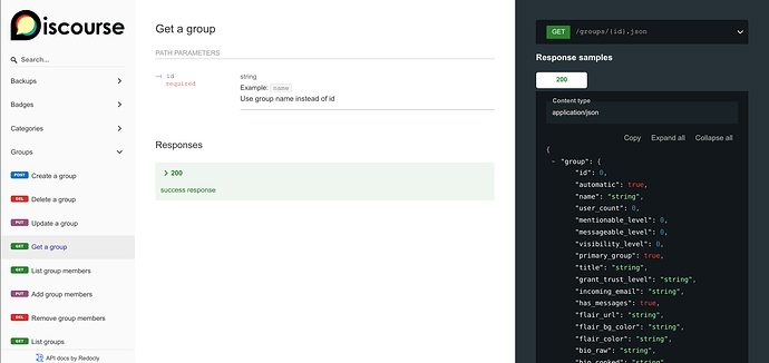

  2. Browse to http://localhost:3001 to see the updated documentation.

Reference : Discourse API Documentation Get a Group
Actions: Groups/ Get a Group
  • In documentation path parameter is shown as id ,when queried the path doesn’t exist
  • When reverse engineered same query via discourse UI the path parameter is group name and same works via API Key
