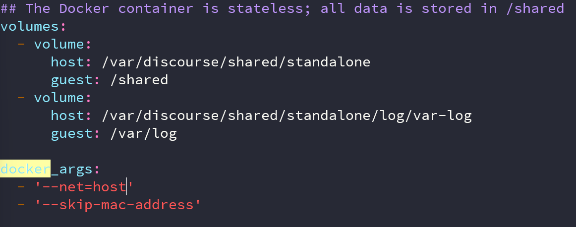

I’m trying to install discourse using docker host networking and am running into a weird error with the rebuild command.
If I run ./launcher rebuild app --docker-args --net=host --skip-mac-address then discourse will rebuild without issue and is accessible from my load balancer.
But if I add the configuration to container/app.yml instead then I get an error at the beginning of the rebuild process.

I would like to add this as part of the configuration so that if myself or another admin comes and rebuild, or something similar, we won’t need to remember to add the extra flags every time.
