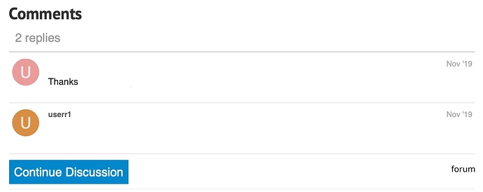

Here’s what it should look like when it’s working (some text censored):
