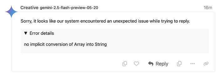

Hi everyone,
I’ve encountered an issue while using the Discourse AI plugin with Gemini integration. When I try to analyze posts that contain images, I get the following error message:
no implicit conversion of Array into String
What happens
If the post only contains text, everything works as expected.
If the post includes an image , the analysis fails with this error.
Environment
Installed 3.5.0.beta8-dev (70dbb95041 )
Thanks for your help!

When I include an image in a public post, Gemini returns no reply,
when I send it via private message, the AI reports the error shown above.
The same behavior occurs across multiple AI models.
Only the default “creative” bot produces the above error; other custom AI bot can successfully recognize the image and respond normally.

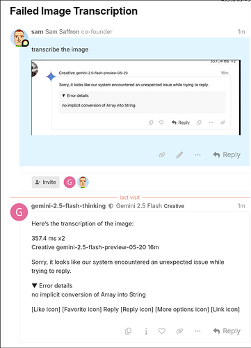

I am having trouble with a repro here, using creative with images enabled:
Can you share how your LLM is configured, be sure to use the non preview 2.0 / 2.5 flash model now that it is released.

מאושר: לאחר שהסרתי את תצורת ה-RAG, פונקציונליות ניתוח התמונות חזרה לקדמותה. תודה על העזרה!

@Roman_Rizzi תיקן את בעיות ה-RAG, אז אני מניח שהכל בסדר עכשיו, תודה על הדיווח!
