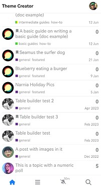

I am working on a new theme component based on Discourse Tab Bar for Mobile.
The theme component adds the ability to use functions to the tabs. These function now can be hamburger, notifications, search.
  • Hamburger: tab opens hamburger menu
  • Notifications: adds notifications to the tab
  • Search: opens context based /search
It also modifies the header icons. Removes hamburger, user-menu, search and adds a new DMenu avatar which contains the user menu profile content. When you scroll down it hides everywhere except in topic the header to maximize the view.
It change the notification tab bell icon to bell-slash if do not disturb is active and adds the time. It also dynamically change the route if there is reviewable then it redirect to /review otherwise it goes to /notifications page.
Here is the demo: Theme Creator
That’s it right now…
What do you think? Thanks :slightly_smiling_face:

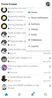

Separating the notifications makes a lot of sense. The Central theme does the same, making the user menu easier to access and comfortable (feels less imposing). It’s straight, and you have the essential links. This is such a big UX improvement IMO, love it.
About the links inside the menu:
  • I would replace the word “Summary” with “Profile”; it’s easier to understand in this context.
  • “Activity” is not super helpful; I would replace it with “Messages” instead. Direct access to your inbox is a must-have.
  • I think a “Bookmark” would be welcome too.
I’m not sure about the bottom panel. :thinking:
I guess I’m not used to looking at the bottom.
  • The notification button should open the right panel instead of going to the profile. The view is more suited when you want to take a fast look, and you don’t have extra content unrelated to the notification.
The hamburger menu opens with a brief blink effect.
I hope the feedback helps. :+1:
