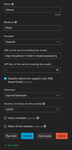

Ich habe Folgendes getan:
ollama serve
ollama run phi4
# Test
curl http://localhost:11434/v1/chat/completions \
              -H "Content-Type: application/json" \
              -d '{
              "model": "phi4",
              "messages": [
                      "role": "system",
                      "content": "You are a helpful assistant."
                      "role": "user",
                      "content": "How much is 1+1?"
          }' -s | jq .choices[].message.content
"Die Summe von 1 + 1 ist 2.
In der grundlegenden Arithmetik, wenn Sie eine Einheit zu einer anderen einzelnen Einheit hinzufügen, wird die Gesamtzahl zwei Einheiten. Diese Operation ist Teil der grundlegenden Additionsprinzipien, die in der Mathematik verwendet werden. Kann ich Ihnen sonst noch bei Mathematik oder einem anderen Thema behilflich sein?"
Auf Helper getestet

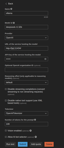

I notice that I’ve got an extra option (Disable streaming completions) compared to your config. Is it possible it’s the model selection that’s causing an issue for me? (I’ve got deepseek-r1:32b installed).
              -d '{
              "model": "deepseek-r1:32b",
              "messages": [
                      "role": "system",
                      "role": "user",
"<think>\nAlright, I'm trying to figure out how much 1 plus 1 equals. Okay, so let's break this down step by step even though it seems simple.\n\nFirst, I know that addition is combining two numbers to get a total sum. So, when we say 1 + 1, we're essentially putting together one object and another object to see how many we have in total.\n\nLet me visualize it: imagine I have one apple in my left hand and another apple in my right hand. If I put them together, how many apples do I have? It should be two apples, right?\n\nAnother way to think about it is using a number line. Starting at the number 1, if I move forward by one more step, where do I land? That's right, on the number 2.\n\nI can also use my fingers to count. Hold up one finger on my left hand and another on my right. Now, count them all: one, two. So that gives me a total of two fingers, which means 1 + 1 = 2.\n\nMaybe I should check if there's another perspective or method. For instance, in binary, the number system used by computers, 1 + 1 equals 10 because it carries over after reaching 2 (which is represented as 10). But that's a different context. In standard base-10 arithmetic, which we use daily, 1 + 1 remains 2.\n\nLet me also consider the concept of sets. If I have a set containing one element and another set with one element, combining them would result in a set with two elements. That reinforces that 1 + 1 equals 2.\n\nI might wonder if there's any scenario where 1 + 1 doesn't equal 2. But within the realm of basic arithmetic and mathematics as we learn it, the answer is consistently two.\n\nTo make sure I'm not missing anything, maybe I should look into some mathematical proofs or principles that confirm this. For example, in Peano axioms, which form the foundation of arithmetic, the idea of adding 1 to 1 would follow the axiom that every natural number has a successor, and 2 is defined as the successor of 1.\n\nTherefore, putting all these thoughts together—visualizing objects, using a number line, counting fingers, considering sets, and even touching on mathematical axioms—it all points towards 1 + 1 equaling 2.\n</think>\n\nThe result of adding 1 and 1 together is 2. This can be seen in simple arithmetic and various ways of visualizing the problem.\n\n**Answer:**  \n$1 + 1 = \\boxed{2}$"
Similar result, though I get the <think> tags with this particular model - so maybe the model won’t be suitable for this use.
I’ve just rebuilt (ie, ./launcher rebuild app) my installation and made sure everything is current - I show “all up-to-date” in my Update page.
Selecting either deepseek-r1:32b or phi4 (which I installed and tested as well), I still am getting the internal server error response in the browser.
But in my logs, I’m seeing something new.
