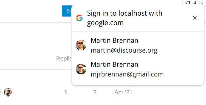

This plugin adds support for Google One Tap sign-in and sign-up to Discourse. When this plugin is installed and configured, anonymous users will see a prompt that looks like this:
From that prompt, they can use any Google account they’re currently logged-in to signup or login (if they already have an account on your site with the same email address) to your Discourse instance.

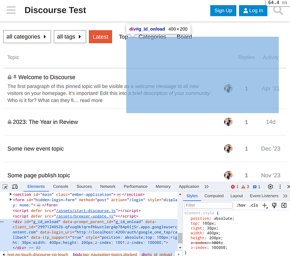

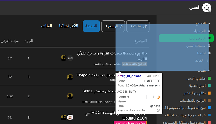

Thanks for the great plugin, however there seems to bug, where the plugin creates an invisible div, making it impossible to interact with any element below it.
It also creates extra space on the left side of the page on mobile.
Mobile:
Desktop:
1 me gusta

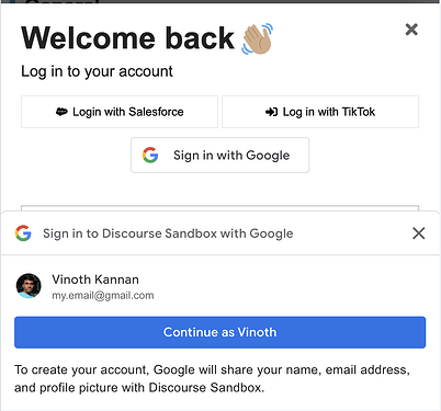

Hey Don can you please expand on this with a bit more information, and possibly some screenshots? I was able to get it working locally:
However in incognito mode I do experience the same issue:
There could be a lot of reasons for this; one for example is the “exponential cool down” Google added:
There may potentially be some way we can detect that this was not loaded correctly – but at least in chrome the element with “Sign in to localhost with google.com” is not even an element on the page. Maybe we can use this?
google.accounts.id.prompt((notification) => {
    console.log(notification)
This PR should fix the issue. @Osama I removed a few CSS styles. Can you please check it when you’re free?

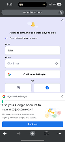

I think this one-tap is what is commonly seen as the Google account creation prompt when you hit a site, for example like this:
I believe the main difference between this and the native google auth support is this triggers when someone hits a page rather than a user finding their way to the login/signup prompt.

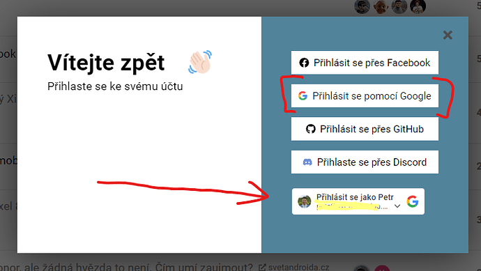

That solution has (or had) some issues that made login actually more difficult, and it looked messy on mobiles. Sorry, that is really useless answer, because I can’t remember any more what were those issues why I disabled it — even when majority is using Gmail here on Finland.
Bump, just noticed this as well.
Not use that ”ordinary” Google login. It isn’t any harder. I kept both, because one tap isn’t active in every situations.
Exactly, but I don’t want to choose between having two redundant buttons or none at all in some situations. :slight_smile:
