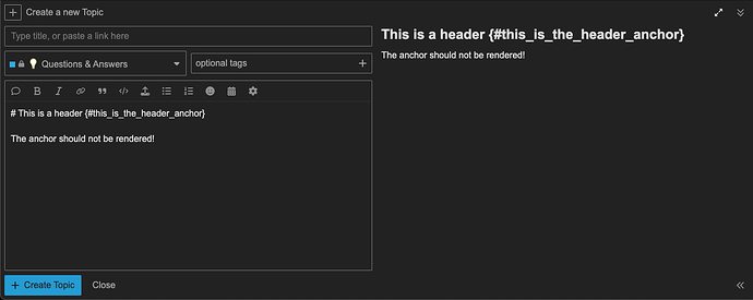

Hey community, I am using a discourse site to publish some specs that are primarily written in markdown, but I came to the problem that the anchors used for the headers are being rendered, while they should be hidden.
Does anyone know if there is a way to hide them?

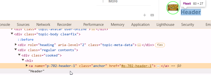

You can see it here:
Essentially, you can expect those IDs:
  • h-{headingId} (no post ID, no slug)
  • h-{slug}-{headingId} (no post ID)
  • p-{postId}-h-{headingId} (post ID, no slug)
  • p-{postId}-h-{slug}-{headingId} (post ID, slug)
E.g.:

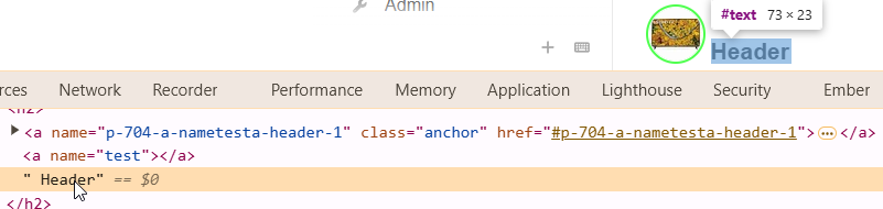

If you’re still interested, I made a tiny Discourse plugin that handles specifying an anchor ID next to the heading.
It works alongside Discourse’s automatic heading anchors.
Note that it’s basic support. There are probably a lot of variants, but this plugin supports only the following:
## My Heading {#custom_section}
will generate:
<a name="custom_section" href="#custom_section" class="custom-anchor-id"></a>
You can give it a try! Let me know if you have any issues with it.
