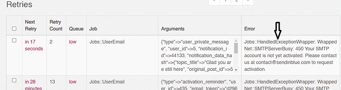

I had a certified Discourse Support person help us changing Discourse servers, and after that, Discourse did not send out automated emails anymore. I checked the error-log and it told me to contact Sendingblue to activate SMTP, which I did (and they activated it):

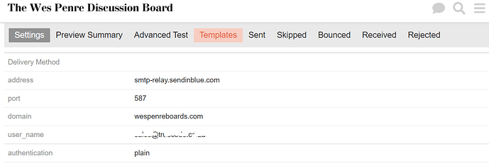

However, it still didn’t work, so I found that under admin/settings/emails, the Discourse Support person’s email was listed instead of my email:
I have tried to reach this support person for almost two weeks, but he is not answering his emails, and I can’t reach him on any of his platforms. How do I change his email address to mine?

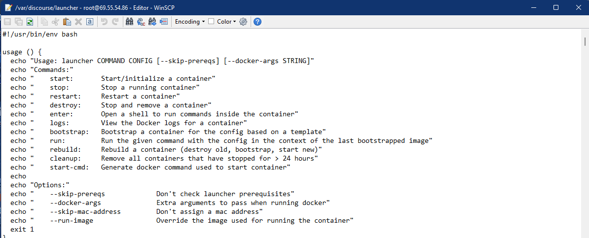

I have never done this before, so please bear with me. I am trying to back it all up using the link you gave me: Backup discourse from the command line .
So, now I’m in ./launcher (see photo).

I have no idea how to do this. I have the launcher window up. What do I do next? How and where do I run the backup, etc.?
I’m afraid I’m unfamiliar with WinSCP. I’ve downloaded and set it up it now, but I won’t get a chance to look at it properly until later.
If you can SSH into your server using something like Windows powershell, or even the ‘access console’ option if you’re with Digital Ocean, then I can probably help you quicker. :slightly_smiling_face:

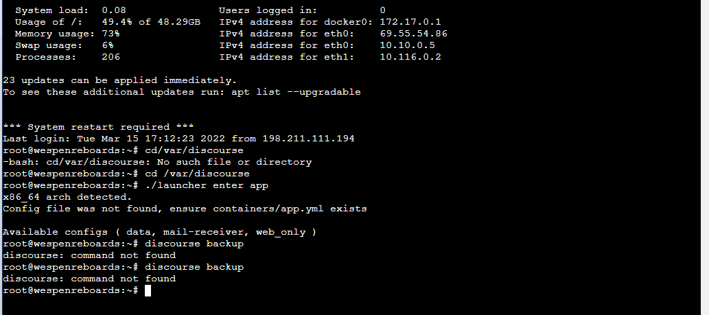

This seems so much easier! Now, everything went fine until I entered, discourse backup . It says ‘command not found.’
And I’ve entered it with a space between discourse and backup.
I should have done this:
I don’t have the data.yml apparently.
Ah, it looks like you have a two-container set-up.
Let me just double check which one we want to amend.
1 Mi Piace
You want to do this:
cd /var/discourse
./launcher enter web_only
discourse  backup
When you go to get the data with winSCP you’ll look in /var/discourse/shared/web-only/backups/defau/t (unless it’s web_only, but I think it has the dash there).
