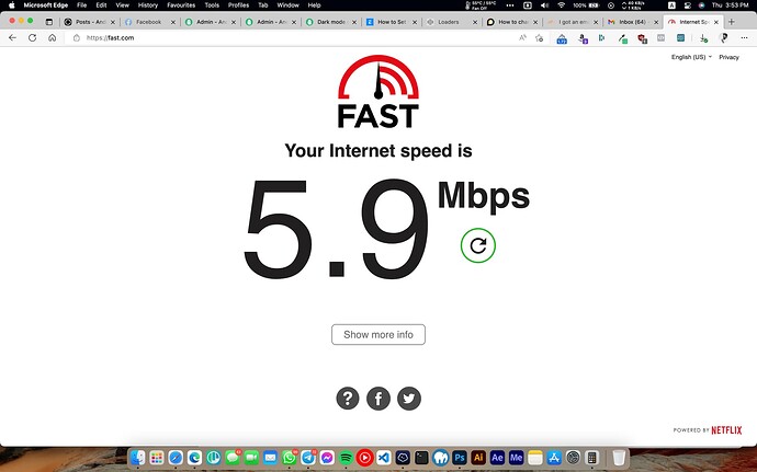

The actual problem is not the server issue or else. I am from Sri Lanka. These days we are in a massive economic crisis. Due to the economic crisis, authorities are commencing powercuts because they cannot manage fuel powerplants. Due to these power cuts, telecommunication companies have degraded the speed of their internet services to save their battery power consumption. Therefore our Internet speed is too low these days.

This is the internet speed right now :smiling_face_with_tear:

Well, the situation in Sri Lanka is bad indeed, Your case is an exception, if/when your main audience is from Sri Lanka too.
