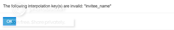

Estou tentando instalar o Discourse e usá-lo no meu idioma nativo (grego), mas há erros no arquivo de tradução que gostaria de corrigir. Os piores erros que não consigo resolver são os nomes de variáveis (como o usado na mensagem de boas-vindas), que foram traduzidos para o meu idioma, fazendo com que a mensagem de boas-vindas (e não apenas ela) chegue quebrada.

Se eu tentar substituir qualquer variável pelo seu nome original em inglês, recebo a seguinte mensagem de erro:
That is because the keys have to be in English (the values in {}).
Good catch on adding this validation @tgxworld!

What are the keys that you’re having trouble translating?
It is in the screenshot in the first post. Those substitution words should not be translated.

I was requesting for the translation keys for the translation not the interpolation keys. Anyway I think I’ll just write a script to find all the broken translations.

Ok I’ve added a test to check for translated interpolation keys in our translation files whenever we pull down new translations
https://github.com/discourse/discourse/commit/b9fbc95ef42c3aa722a8dd7e29ddbf5dab83899c
All the broken translations have been fixed on Transifex as well.

This is good news @tgxworld Thanks!!! What should we do to fix our discourse installations now?
Upgrade to the lastest version :slight_smile:

I did the upgrade and although some keys seem to be fixed, “invite_forum_mailer.text_body_template” still have translated variables. Can you check that please?

Hmm I’m pretty sure the interpolation keys have been corrected. Maybe try rebuilding again?
I rebuilded again but this template still has a problem…
