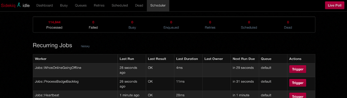

Easiest way is to visit /sidekiq/scheduler and look for any jobs with the word “grant” in the name. You probably want Jobs::BadgeGrant, but some badges have their own tasks.
I went through all scheduled tasks in sidekiq up to 24 hours from now, and none have grant token in them.
Oh… weird. So you don’t see a line like this?

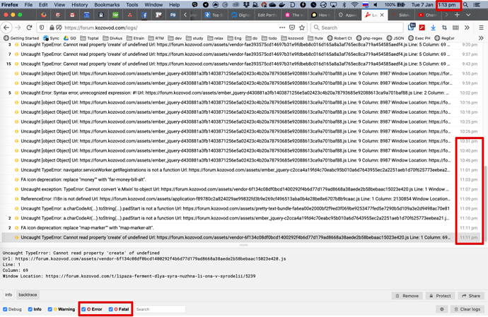

Yes, probably. Do you have any errors in /logs? Any unusual plugins?
Hm nothing critical in the latest ~20 minutes:
Can you see anything suspicious that can break the badges execution / scheduling?

After that, no new errors in /logs.

Just checking - are you looking in “Scheduled” or “Scheduler”? The badge jobs should be under Scheduler.
(Aside: wow that’s confusing naming!)
Thanks.
Under Scheduler, I can now see the following ones:
  • Jobs::GrantNewUserOfTheMonthBadges
  • Jobs::GrantAnniversaryBadges
  • Jobs::BadgeGrant
All Scheduler jobs apper under the " Recurring Jobs" section.
Now, is it safe for me to click on the “Trigger” button and see what happens?
Ah good - that makes this much simpler to solve!
Yes, the trigger button is safe :slight_smile:
