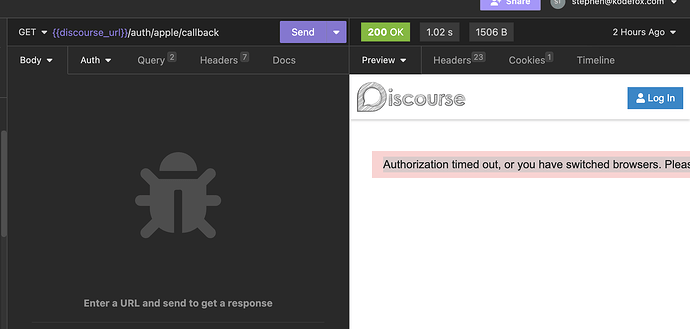

Aber wenn ich versuche, die API aufzurufen, wird der Fehler Authorization timed out, or you have switched browsers. Please try again. angezeigt.
Also habe ich es erneut mit einem neuen von Apple generierten Code versucht, aber immer noch den gleichen Fehler erhalten.

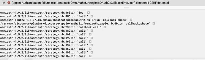

Und wenn ich das Log überprüfe, wird angezeigt:
Started GET "/auth/apple/callback?code=c32f105b5084d42b8bd3e7051873ddb55.0.rrzxz.pChPU9zGlXIHHhgEXLiA5g&state=fbi3bbboud" for
(apple) Setup endpoint detected, running now.
(apple) Callback phase initiated.
(apple) Authentication failure! csrf_detected: OmniAuth::Strategies::OAuth2::CallbackError, csrf_detected | CSRF detected
Started GET "/auth/failure?message=csrf_detected&strategy=apple" for 123.253.233.16 at 2023-11-27 06:10:28 +0000
Processing by Users::OmniauthCallbacksController#failure as HTML
  Parameters: {"message"=>"csrf_detected", "strategy"=>"apple"}
  Rendered users/omniauth_callbacks/failure.html.erb within layouts/no_ember (Duration: 4.1ms | Allocations: 17)
  Rendered layout layouts/no_ember.html.erb (Duration: 57.5ms | Allocations: 2882)
Message (47 copies reported)
Backtrace
/var/www/discourse/vendor/bundle/ruby/3.2.0/gems/omniauth-1.9.2/lib/omniauth/strategy.rb:163:in `log'
/var/www/discourse/vendor/bundle/ruby/3.2.0/gems/omniauth-1.9.2/lib/omniauth/strategy.rb:486:in `fail!'
/var/www/discourse/vendor/bundle/ruby/3.2.0/gems/omniauth-oauth2-1.7.3/lib/omniauth/strategies/oauth2.rb:87:in `callback_phase'
/var/www/discourse/plugins/discourse-apple-auth/lib/omniauth_apple.rb:60:in `callback_phase'
/var/www/discourse/vendor/bundle/ruby/3.2.0/gems/omniauth-1.9.2/lib/omniauth/strategy.rb:238:in `callback_call'
/var/www/discourse/vendor/bundle/ruby/3.2.0/gems/omniauth-1.9.2/lib/omniauth/strategy.rb:189:in `call!'
/var/www/discourse/vendor/bundle/ruby/3.2.0/gems/omniauth-1.9.2/lib/omniauth/strategy.rb:169:in `call'
/var/www/discourse/vendor/bundle/ruby/3.2.0/gems/omniauth-1.9.2/lib/omniauth/strategy.rb:192:in `call!'
Ich möchte also fragen, ob diese Richtung zur Verwendung der Discourse-Apple-Anmeldung über API korrekt ist und wie ich das Problem mit dem csrf_detected-Fehler lösen kann.
Die Apple-Authentifizierung (und tatsächlich alle anderen Authentifizierungsmethoden in Discourse) sind nicht für die Verwendung über die API konzipiert. Sie sollten direkt von Endbenutzern in einem unterstützten Browser verwendet werden.
Welches Problem versuchen Sie hier zu lösen? Vielleicht können wir eine alternative Lösung finden?

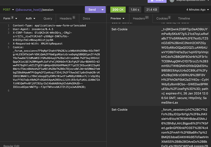

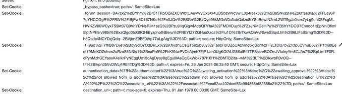

Hallo @david, danke für deine Antwort. Was ich hier erreichen möchte, ist die Erstellung einer API für die Apple-Anmeldung, die von der mobilen App für den Zugriff auf die Discourse-API verwendet wird.

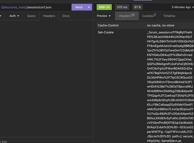

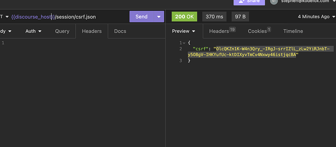

Für die Verwendung der Discourse-API zur Anmeldung mit E-Mail und Passwort funktioniert dies gut mit den folgenden beiden Discourse-APIs:
  1. {{discourse_host}}/session/csrf.json: Diese API gibt einen Cookie und einen CSRF-Code zurück, die für die Anmeldung mit der nächsten API verwendet werden.
  2. {{discourse_host}}/session: Diese API gibt einen neuen Cookie zurück, der für den Zugriff auf andere Discourse-APIs verwendet werden kann.
Csrf API
Session
Ich erwarte, dass es ähnlich wie bei der Apple-Anmeldung in Discourse ist, wo ich eine Anfrage an die Discourse-API stelle, um den _t-Cookie zu generieren.
