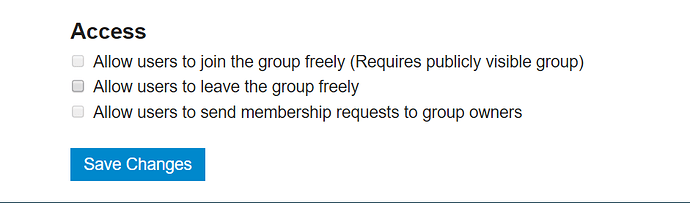

Just setting his up now and I can’t seem to tick the box ‘‘allow users to send membership requests to the group owners box’’
I can’t seem to tick the required box, it’s grayed out as it were… is this because I have set something else up wrong so where else?
The group visibility needs to be set to ‘Everyone’, otherwise people can’t see the group to be able to ask to join it.
If you change it from Everyone then the box gets disabled automatically.

Shouldn’t that bottom most one also have the parenthesized disclaimer as well (requires publicly visible group) @sam?
We may need to rework the wording a bit given @pmusaraj pending changes. Some groups may be only visible to logged on users, not public per se
