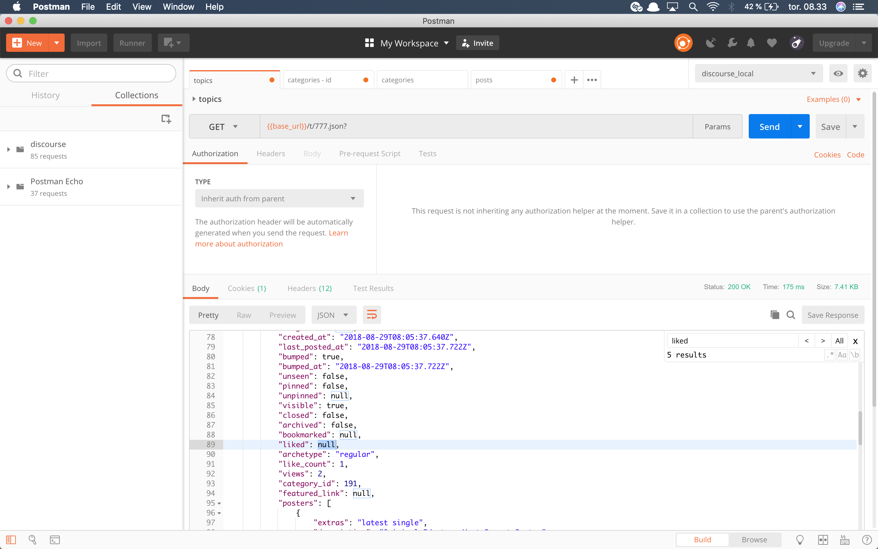

Okay I tested it in the postman
As you can see the like_count is 1.
Why is my liked attribute null?
In my system the property ‘liked’ that you are referring to is going from null to false upon liking. The id that is passed as ‘likesId’ on the picture below is the id of the topic I am trying to like.
Do you have any explanation for this behaviour, or possibly a solution, so that the property returns true as intended, upon posting a like? It seems to be hindered by something.
Thank you

I have really been trying to understand the database structure and I admit to fail miserably at that. The only thing I can see is that on the live and dev site we have a difference in the response of a “not yet liked” idea. If you’d like to take a look at the responses I have some well documented pictures. It seems that liked property on the running site for “%liked” ideas is false, and on alpha site it is null by default.
Live:
Problem inducing Alpha site response:
These are both Topics and have not been liked.
That looks like JSON for the latest topic list page. The “liked” is whether or not you liked a post in the topic. (false if you read it but didn’t Like, null if you didn’t read it while logged in). The “like_count” is the number of likes for all the posts in the topic combined.
