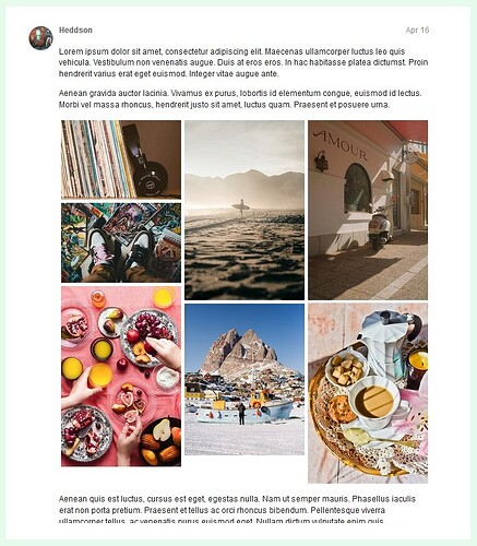

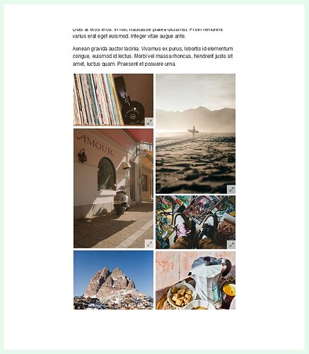

This theme component adds a responsive masonry-style image gallery with customizable ordering.
Desktop view:
Mobile view:

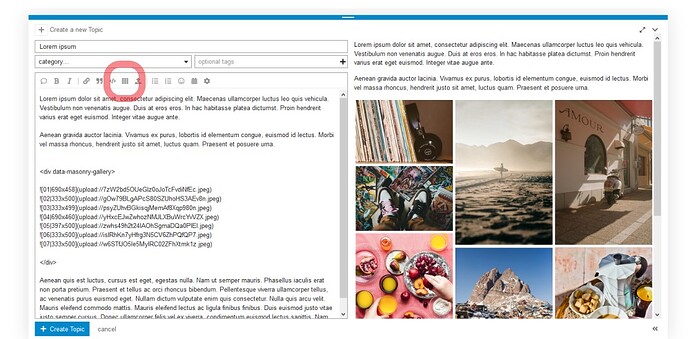

You add the gallery by clicking on the grid icon and then adding your images. It also works by first selecting the uploaded images and then clicking the icon.

The default order is horizontal, but can be changed in the settings. It’s also possible to change the order of a specific gallery by adding vertical/horizontal (v/h works as well) to the attribute in the composer like this <div data-masonry-gallery="vertical">.
