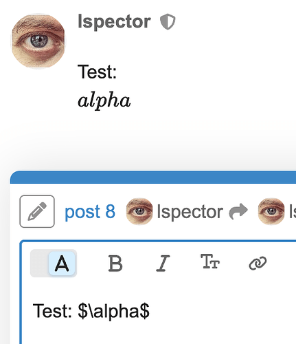

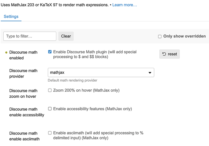

Thanks but even the lower-case ones are not currently working for me, though they used to. I’m including a screenshot of my math plugin settings below, along with a screenshot of what I put in a post and how it appears when posted… FWIW I’ve tried some other settings for the plugin, but nothing has fixed it. Am I doing something obviously wrong, or do you have any other suggestions?
It worked for me, but RTE doesn’t show as WYSIWYG, until that post is sended. Markdown shows right in preview.
Does it work when you use the markdown editor instead of the rich text editor?
I think @mcmcclur mentioned that math and the new rich text editor currently don’t work well together.

It seems like the default editor was changed, which had the side effect of breaking mathjax.
I no longer get the preview pane, I guess because the main pane is now supposed to be WYSIWYG, which is not something I actually want.
Sadly, I don’t understand how to make this new editor go away. I see stuff at one of the links y’all provided about CSS but I don’t even know where I would put it, even if I understood it.
My site is managed by discourse.org, and I don’t think I have anything local… or is there some place I can access via settings that I can put it?
I’d like to banish the visual editor, get the preview pane back, and most importantly, get math formatting to work again.
Is there a straightforward way for me to do this?
@moin linked to it in the post before mine.
You can change the Default composition mode site setting to markdown.
