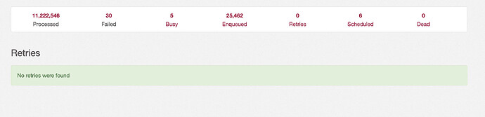

What is in Retries tab of sidekiq?
Here there are 6 jobs being retried. Thatâs an ok number and I know why.
If this is in the 1000âs thatâs not good and you need to take action.

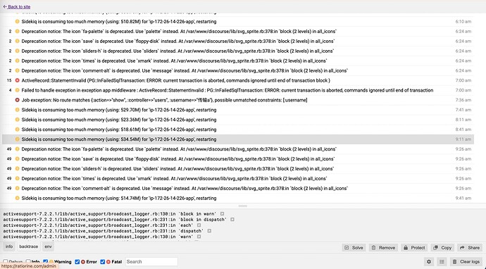

Have you got any errors in Email Logs or the Server Error Logs /logs?

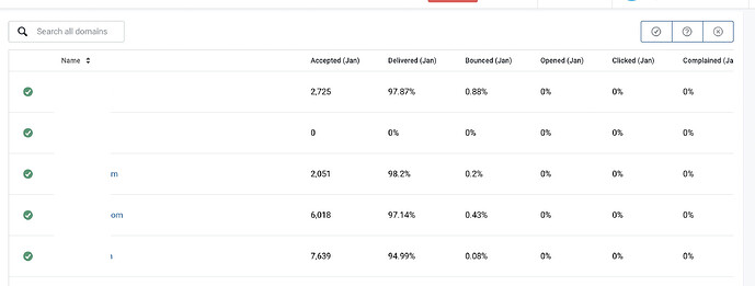

Is your email service provider throttling you? Have you exceeded their rate limits for the level of service you are on? Have you paid your bill with them?
Is the entire queue all UserEmail jobs (for the most part)?

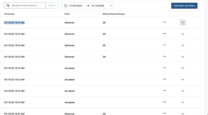

Check your email service dashboard (over at your email service provider, not on Discourse) and see if there is any information there
Do they have an audit trail, can you see a tick-over of continuously sent mails?
Last email sent?

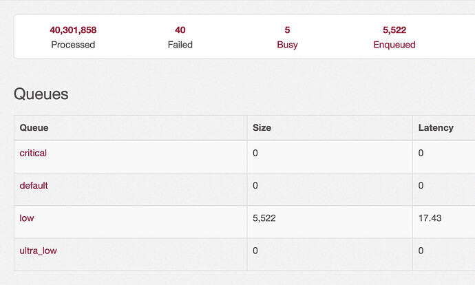

So some are getting through, but is it processing them fast enough?

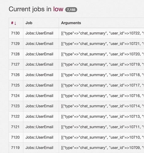

on discourse (admin/email/sent) I saw the chat summary email was send with a low frequency like at most 5-6 per day, most time only 1 or none.
how come it create so many jobs in sidekiq?

also looked at the ids, it seems the system is trying to send chat summary to every users ![]()
is it normal?

How âfastâ (or slowly
) does the low queue get processed?

We have a query that list all the âusers with unreadâ mentions or dms for chat, and, in trying to be too clever, it ended being wrong. Instead of enqueue a âchat summaryâ (aka. email notification) for mentions in channels or unread in dms, it was enqueueing a job for every messages
Since that job ran every 5 minutes, it easily bloated sidekiq with useless jobs⌠(note: the email were thankfully not being sent as we would not be able to retrieve any mentions).
