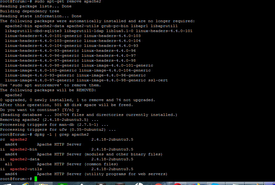

13
okay, try running sudo apt-get remove apache2
If that doesn’t solve the issue, run dpkg -l | grep apache2 and remove each remaining component

14
cpradio:
I tried both but problem still exists

16
Run the sudo lsof -i tcp:80 -s tcp:listen command again, is anything listening on port 80 anymore? From what I can tell, that is simply implying that apache2-bin apache2-data apache2-utils can be manually removed as well.
sudo apt-get remove apache2-bin apache2-data apache2-utils
The rc in front of apache2 means it was removed, but still has configuration files sitting on the system.
