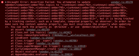

When you do something like this
this.topics = something_else
You’re redefining that property to something else. This is fine if nothing else is watching that property, but in this case, several things are watching the topics array.
For example
If you do this on a development installation, Ember will throw errors in the console like so.
So, the key takeaway here is to do something like this instead.
this.set("topics", something_else)
until the @tracked decorator lands in Discourse.

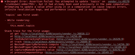

However…
If you try that on development installation, you’ll see another error.
So this should tell you something. The topics array is being used in many different places. So it’s not a good idea to muck around with it - especially since your use case is primarily visual and there are no security implications involved.
