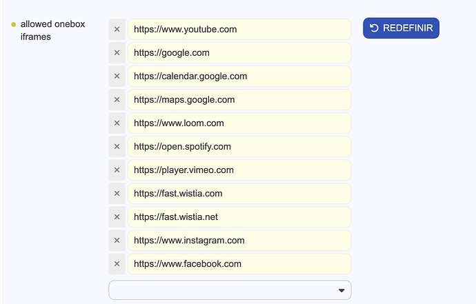

Is there a Photobucket support or a way to add this to the list of onebox allowed domains?
