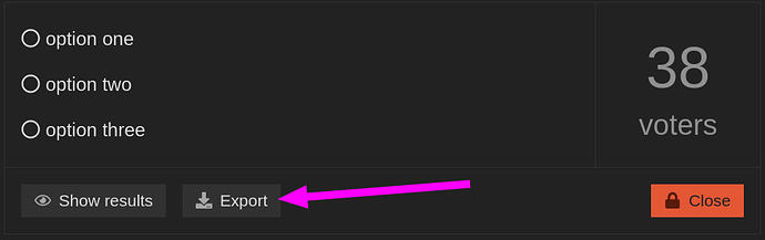

This is now available for staff by default on polls:
You need the latest version of Discourse and Data Explorer plugin enabled for it to work.
You can also customize the CSV output by writing a new query and changing the query ID for the export in settings.
7 إعجابات
