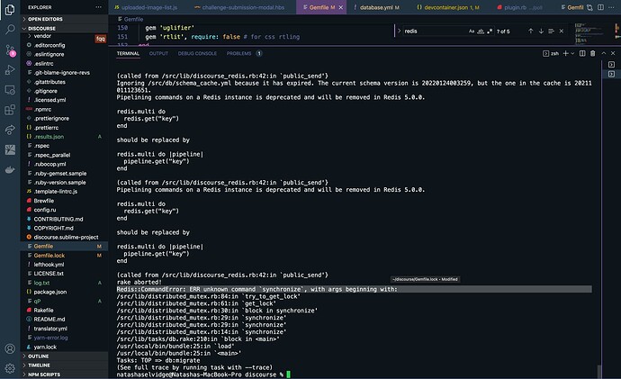

I keep getting this Redis Error when I try to migrate my db. This discourse docker install. Please help.
Do you have a 2 container install or redis hosted elsewhere? Do you have redis 6.2?
This is my Redis version 6.2.6 and I only have one redis container in my docker and then a few discourse_dev containers too.
I have requested help on the sidekiq github too.
This is what comes up when I run in my docker container
d/bundle show redis
/Users/natashaselvidge/discourse/vendor/bundle/ruby/2.6.0/gems/redis-4.6.0

natashaselvidge@Natashas-MacBook-Pro discourse % d/rake db:migrate

rake aborted!
Redis::CommandError: ERR unknown command `synchronize`, with args beginning with:
/src/lib/distributed_mutex.rb:84:in `try_to_get_lock'
/src/lib/distributed_mutex.rb:61:in `get_lock'
/src/lib/distributed_mutex.rb:30:in `block in synchronize'
/src/lib/distributed_mutex.rb:29:in `synchronize'
/src/lib/distributed_mutex.rb:14:in `synchronize'
/src/lib/tasks/db.rake:210:in `block in <main>'
Tasks: TOP => db:migrate
(See full trace by running task with --trace)
Looks like you manually update the Redis gem on your dev environment from 4.5.1 to 4.6.0. Discourse doesn’t work with that gem version, so you need to revert back to the version we use on the Gemfile.lock file.
We are working on eventually moving to redis-rb 4.6.0, but that is a lot of work:
https://github.com/discourse/discourse/pull/15811
Ohhhh okay, thank you so much! I will try that :folded_hands:t3:
Update
For anyone who may need this in the future :hugs:
Thank you so much that fixed it! I updated my discourse, but the version wasn’t specified on the gem file. I added the version number to the end like this: gem ‘redis’, “~> 4.5.1”
We specify it at the Gemfile.lock:
I think because I deleted my Gemfile lock and bundled. Then I was talking to the redis and sidekiq issues guys on Github and they were telling me I had to be on the updated version. Thanks again!
