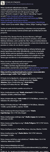

Posts imported with rss-polling contain HTML code. If these posts are federated, most of the HTML code breaks and goes through as plain text.

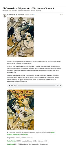

A couple of screenshots to illustrate the problem:
Discourse topic imported via RSS:
This is how it looks on Mastodon:

Looking at the screenshot they posted it still seems like there's almost certainly some kind of bug here, although I can't tell if it's on the Mastodon side or the Discourse side.
Even the most complex HTML should just turn into plain-text when Mastodon parses it. Not whatever broken HTML markup is going on here.
