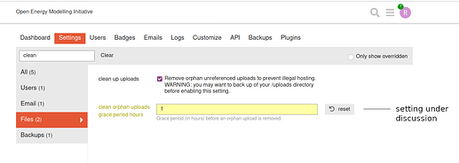

My work around is to alter the following setting to 1 (the default is 48), remove all references in the markup, and wait until the resulting file expunging has occurred:
  • Settings > Files > clean orphan uploads grace period hours
I also tried setting this particular parameter to 0 but that did not seem to work. In which case, the tool tip might better be modified to read: “To disable the grace period set to 0”. Or alternatively as appropriate: “To enable near immediate effect set to 0”.
I cannot tell how often this kind of maintenance is actually run but I was presuming hourly? Maybe it is daily instead? That would be useful to know too.
TIA for any assistance about how to speed up this file renaming process! I do have a work around but it is rather clumsy and slow.
Hourly…
https://github.com/discourse/discourse/blob/master/app/jobs/scheduled/clean_up_uploads.rb
Not being familiar with ruby, but that also looks like 0 means 1. Maybe the parameter tip should also read: “A value of 0 is interpreted as 1.” or something similar. Particularly as zero often has the special meaning of disable in other circumstances. Thanks @neounix.
