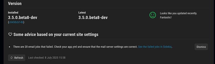

Evening all,
I haven’t really been using my forum, either as an end user or an admin, but I noticed it was a bit quiet. All of a sudden, when looking at the admin panel, I have 42 email jobs, and reading using Gemini, it is related to the provider (Mailgun) not being synced with the provider (DigitalOcean console) through the app.yml. I haven’t changed anything and can’t find anything on this forum about whether we needed to change anything on our side.
Username and now password are correct; other than that, there isn’t much else with the SMTP I can change. The port is also correct, and when I say “now” password, I’ve also changed this.
None of these have been changed since 2022, so what could it be?
