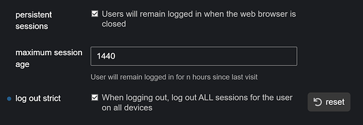

If you want to change the settings @Jaskaran you can check out these site settings

Yes, you can change the time when the system forces a user to log out by adjusting the maximum_session_age setting. This setting determines the maximum number of hours a user remains logged in since their last visit.
Steps to Change the maximum_session_age Setting
  1. Access the Admin Settings:
    • Navigate to your Discourse site.
    • Click on your profile picture in the top right corner.
    • Select “Admin” from the dropdown menu.
    • Go to “Settings” in the left-hand sidebar.
  2. Search for the Setting:
    • Use the search bar at the top of the settings page to search for maximum_session_age.
  3. Adjust the Setting:
    • The default value for maximum_session_age is 1440 hours (60 days).
    • You can set it to any value between 1 hour and 175200 hours (20 years).
  4. Save Changes:
    • After adjusting the setting, make sure to save your changes.
Example:
If you want to set the maximum session age to 30 hours, just change the value to 30.
