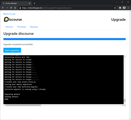

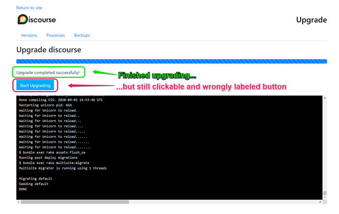

Bouton « Démarrer la mise à niveau » après une mise à niveau réussie
Since some weeks, the “Start Upgrading” button is shown, right after the upgrade did finish.
In my opinion this is a bug, since before this change, there was no button to start the upgrade again.
I suggest to make the button disappear after an upgrade or at least disable it.

Then, today I’ve again did an upgrade and still see this screen:
Could it be possible my ad blocker plays into this?
When looking a the browser console after upgrading, I saw two entries:
/message-bus/fc3f44b30aea4975be751a4cc8736f76/poll:1 Failed to load resource: net::ERR_HTTP2_PROTOCOL_ERROR
docker/upgrade:1 Failed to load resource: the server responded with a status of 504 ()

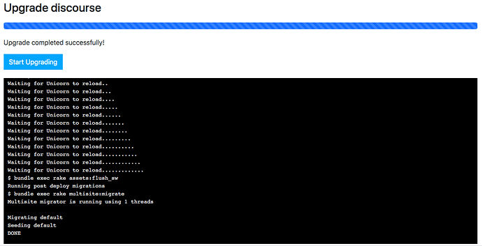

I see the same. Indeed, whatever the ‘Start Upgrading’ button turns into when the upgrade starts - I think it used to change into some kind of Cancel button - I notice it pretty quickly went back to ‘Start Upgrading’ while the upgrade was still in progress, and remained there even after the upgrade was successfully completed. I’m running Chrome Version 86.0.4240.80 (Official Build) (x86_64) on a Mac.
I saw this on a previous upgrade. The present upgrade is to 2.6.0.beta4 from 2.6.0.beta3. I think the immediately previous upgrade required an app rebuild.
Edit: on my other forum, I just saw the same, and took some screenshots. The button flipped back while the log was still showing one of the many Waiting for Unicorn to reload messages at the beginning. (I speculate that the flip is based on time having elapsed, not to do with the progress of the upgrade. Edit: 60 seconds from button press to reversion. Whereas the progress bar first moved at about 90 seconds.) See below:

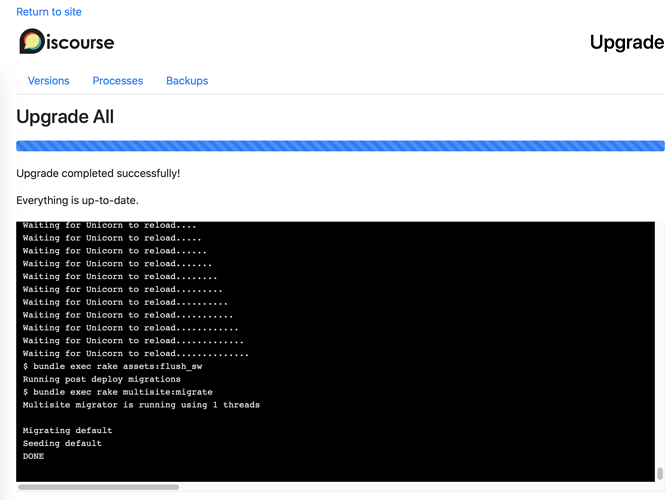

I’ve never seen that - is it part of ‘Upgrade All’?
That’s fine for me, of course. I thought I saw someone say that they’d accidentally clicked Start Upgrading when it reappeared - hopefully that’s harmless. I’ve never used ‘Reset Upgrade’ but presumably it’s a safety feature in case the upgrade gets stuck.
