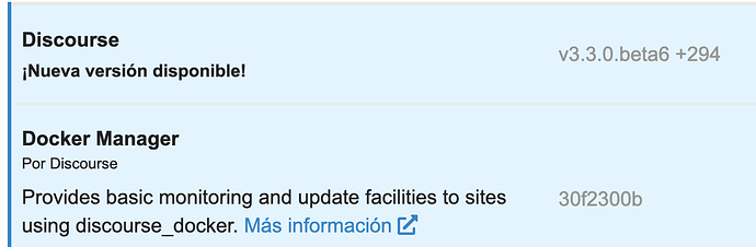

Update:
I still trying things. At this point, I just want to go back to a buld that supports PG13 so I can restore my backup, but I still blocked trying that.
The commit hash before the upgrade was v3.3.0.beta6 +294, im trying to re-build that one vie YML but still saying this when building up:

Before updating I took an screenshot to the current version just in case, is there any way to force discourse_docker to a compatible older version?
I’m trying searching on google and here in meta, but nothing yet about how to do it.
Don’t do that.
