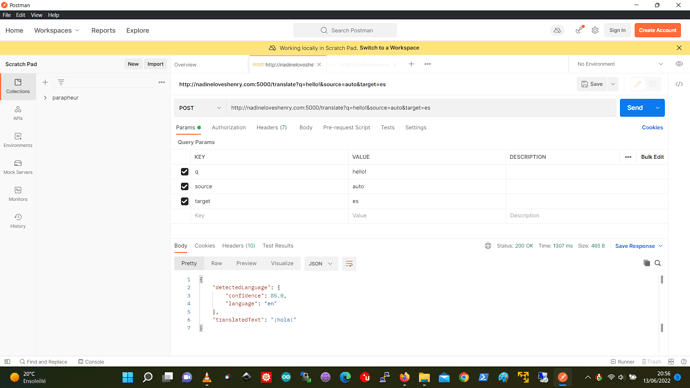

my guess would be http://nadineloveshenry.com:5000/translate
as it seems to work:

ha, my bad, the endpoint should be:
Still don’t know if and how it works though :sweat_smile:
