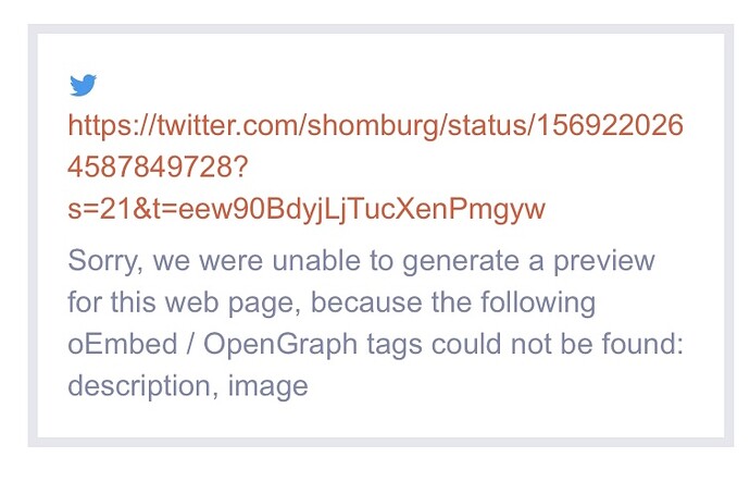

Some time ago Discourse stopped displaying the Twitter links properly as previews. I now only get an error message.
It seems to work for you guys. Why ever!
I am using the latest version. What could be the problem?
Example at meta:
On my instance:

The tweets are still not displayed.
Only the link is displayed.

I tried my best. The API keys (consumer keys) have been renewed. The HTML rebuild function did nothing. Everything is the same.
