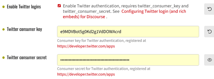

I followed the directions to create a twitter consumer ID and secret (from the developers.x.com portal) using the “free” tier.
When I use these generated values and add them in the discourse settings as shown below I am still getting the same incorrectly unfurled twitter post as described in my original post.
Note that my discourse instance is a self-hosted on an AWS EC2 instance.
