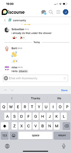

غير قادر على رؤية مربع الدردشة أو الكتابة عند ظهور لافتة
Today when the keyboard appeared I wasn’t able to scroll the main screen down.

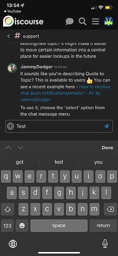

I’ve just noticed. When I type blindly and click “Done” the letters I’ve typed do appear on the message.

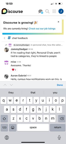

I think it was the banner. When I dismiss it, it all works fine.

The banner only appeared for me after clicking in the reply box and then yes, once I dismissed the banner, I was able to see the reply box again.

Guys, this is still an issue and I believe it’s the banner. It appears it may not be being accounted for in the layout calculations.
When the banner is dismissed the issue goes away as per @jimkleiber

@merefield I suspect we may have a few of these issues still lingering around so I just want to check which one you saw most recently. Was it here meta with the “we’re hiring” banner? Or something else?
إعجابَين (2)
Yes, it was the “we’re hiring” banner specifically.
