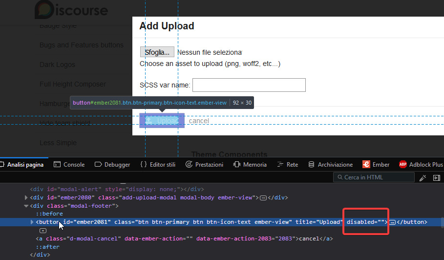

I was trying to upload an image for facebook open graph via upload option in customize, but the upload button is grayed out. I am unable to upload the image. It seems like a bug to me. Any idea?

Bug confirmado aqui no Meta.
Por algum motivo, o botão está desabilitado por padrão.
@Pravi, como uma solução temporária, você pode editar o HTML excluindo a parte destacada na imagem acima. O botão voltará a ser clicável e funcional.

Thank you so much.. The temporary solution worked.
Hope you guys will fix the bugs soon.
Looks like a valid bug @sam
The regex changed in this commit FIX: validates 'ThemeField' name when used in a SCSS variable · discourse/discourse@24e89b6 · GitHub is causing the issue.
This regex will fail if your image is capitalized like : IMG_0039 for example, not sure about the motivation to only allow downcase.

Thanks for reporting that @Pravi. I’ve pushed a fix :banana:
https://github.com/discourse/discourse/commit/27a368bb70c2755598d38c728e589ab2968d40ac
