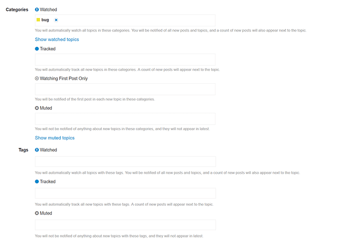

encountered this bug recently:
  1. Start by clicking the Category dropdown menu, and choose any category.
  2. While in the selected category space, click on the watch/track button next to + New Topic
  3. Choose to watch the category
  4. Refresh page, then try to unwatch the category by setting it to other option (like Normal or Watching First Post)
  5. Refresh page, the category is still being watched (Watching is still selected).
  6. Only way to unwatch the category is through the account preference page.
Shouldn’t user be able to unwatch any category the same way they use to watch one?
