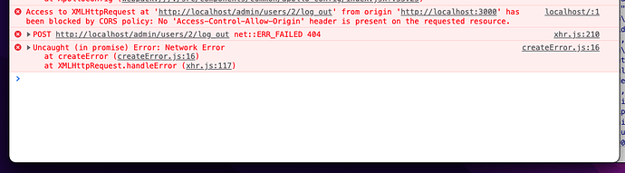

Mas então, quando tento a partir do aplicativo web:
axios.post('http://localhost/admin/users/2/log_out', {}, {
  headers: {
    'User-Api-Key': '<>',
    'Content-Type': 'multipart/form-data'
os logs do servidor mostram:
Started POST "/admin/users/2/log_out" for 172.18.0.1 at 2021-11-30 21:08:26 +0000
ActionController::RoutingError (No route matches [POST] "/admin/users/2/log_out")

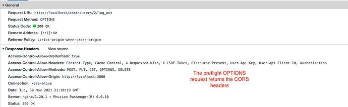

Mais algumas evidências:
xxxxxxxxxxx
xxxxxxxxxxx
