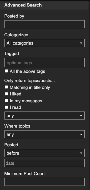

Relating to this:
If I have 100s to 1000s of categories, is there an option for me to limit the number of search results?
My problem: Due to a large number of categories, clicking on the dropdown when creating a new topic, or searching for categories when subscribing to them, has a long delay (10s of seconds).
I know we have an option to restrict the number of results in such scenarios to tags. Do we have/can we have the same for categories?
Hi @Tayyab_Anwar
I just checked the DB for you and there are no settings related to restricting categories (for searches) in the DB.
There are some restrictions in the UI available (as you know):
So, it looks like you would need to create a plugin to add extra features to restrict search results based on categories and related criteria.
Hope this helps.
